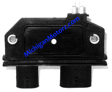

I've tried OEM module, cheaper O'reillys brand and another module and none of them are advancing. But I really can't think of anything else besides the module that would affect advance.

With change no change in advance the module isn't working

Yeah, need to find a good quality module. The OEM says "Elko".

I would try sending both your modules back for replacement as that is the only thing it could be. Unfortunately you aren’t the first person weve seen on here who had to try multiple modules to get one working one.
might be worth a call to a place like Michigan Motorz. When i bought my replacement engine there they were very helpful with good tech support
