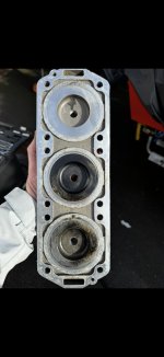

Further update. Installed the new impeller and housing - water cooling is now sorted and running a strong pisser out of head and poppet at idle 👍🏻
This has also been useful as it’s highlighted what I believe is the cause of the primary issue. As soon as I installed the new impeller (and water pressure it up to where it should have been) the cylinders cooling jackets are now full - this is allowing the cylinders to draw in cooling water on the down stroke and putting out the combustion in some of the cylinders. It’s so prevalent that the motor now cuts out on idle, like its mildly hydraulic locking and also won’t run above tick over (it was 4,000RPM last week on low cooling water pressure)
So I’ve pulled the heads and put a straight edge over them and checked them with a feeler gauge - both of the ‘clean pistons / domes’ allow the .003 feeler gauge through easily.
Red crosses show where the feeler slides under.
Also a couple of pics of the cylinder heads and pistons. There’s some visible signs of previous damage (ahead of the rebuild done before I got it) showing witness marks from roller bearings.
