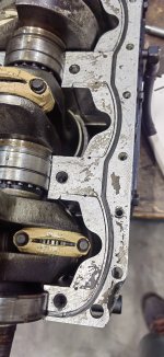

Finally got back to the motor this week end, I got new rings and some used pistons, all look good minor scratches hoping will work well, I have already installed the connecting rods to the crank, that was easier than I thought. Now I would like your suggestions for sealants and loctites to use, reading the srrvice manual it has some recommendations but I believe being 30+ years old this are outdated products.
What do you use for:
1. Loctite for caps screws - manual says loctite T-8936-1
2. sealant for Parting line seal - manual says T 8955
3. Sealant for crank case holes - manual T 8983
Thanks
The Force power
Feb 3, 2019
2,359
Use as prescribed or equivalent.
Suggestion..... don't apply the loctite on the bolts for connecting-rod caps UNTIL you have a perfect fit, then remove & apply one by one

Thanks I have done some reading in other threads, I see suggested for cranck case sealing Loctite 518 I have already orderd that one.
