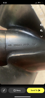

Hey so I took the prop off and I put it in forward gear and when I turn the prop shaft it makes a click sound. It looks like fishing line got tangled in there too. When I put it in reverse it stays locked. Thoughts? And that’s a picture of the side of the prop with whatever numbers those are.

39,581
Yes ----In forward gear it will click if turned CLOCKWISE and lock the other way and that is a fact.---- Somehow I think you seem doubtful or unwilling to believe it can an issue with the prop !

You can get that prop for about 50-60 bucks. Look up how to tell if prop is slipping to confirm its the prop ( which it probably is ) or take it to a shop that's your options..

I think it could be the prop I just thought it was odd that the shaft will turn in gear since it wouldn’t in reverse. I’ll do a test and confirm if it’s slipping.
