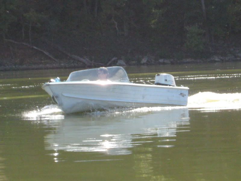

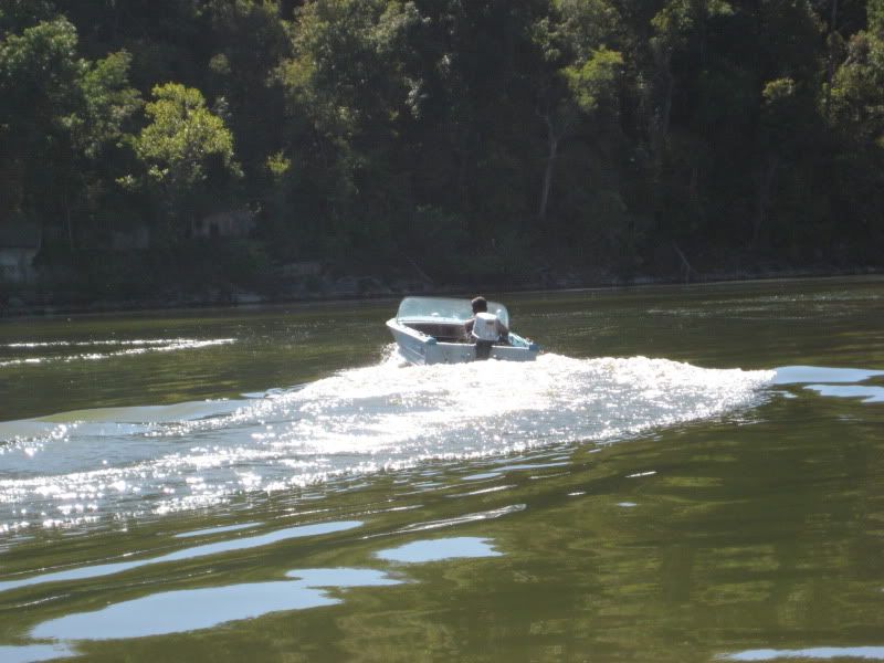

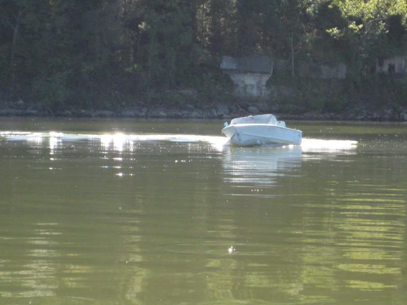

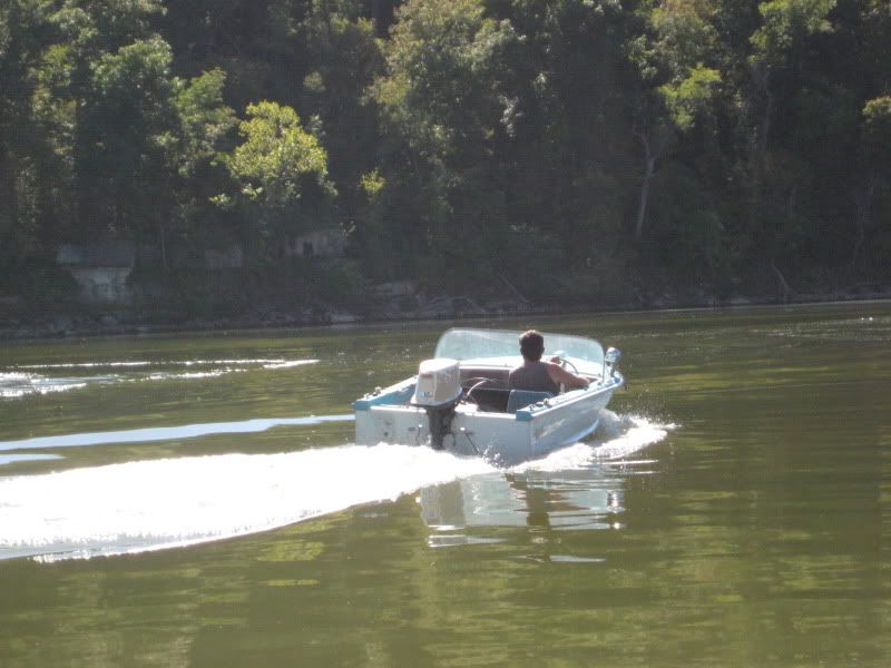

Sorry its taken forever for me to upload more pics, took the boat out last thurs. I think. Motor ran great here idles great etc, doesn't have any power on the water. It might do 5mph with me and my Dad in it. Going to clean the carb and check all the ignition stuff and go from there. Here is some pics of her on the water tho :)
