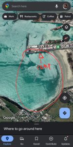

Hi all. I have seen this question asked before but it's normally with relation to deep sea fishing - mine is not.
I have a Stingray 190RS with a Mercruiser 4.3 AlphaOne, I will add a photo or two. She has no leaks and runs well, doesn't overheat or anything. Our closest lake is an hour away but we live a stone's throw away from the ocean. There is a nice sheltered bay, which I will also attach a photo of. I am looking for the opinions of as many as possible on whether I should take my boat into saltwater or not. I would not be heading out into open water, only in the bay with the kids on skis or wakeboards, etc.
If I were to flush the motor out properly on the flushmuffs/hose (like I do every time we get back from the lake) and give her a good soapy wash and a good rinse - am I doing my boat a disservice by putting her in saltwater?
Please excuse all of the photos but I thought I'd include as much information as possible
