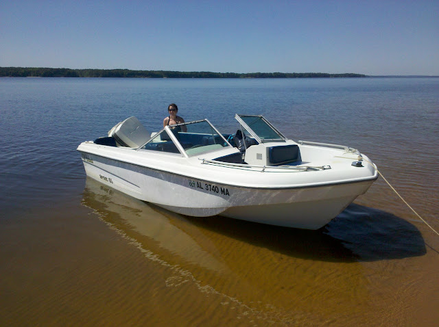

My first day with the family out on the lake! I should have a few action pictures later, but it went flawlessly! The boat ran great! I do need to get a good swim ladder installed, so that will be my next project.

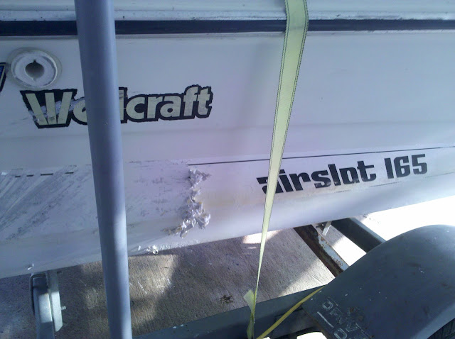

Well today I started removing the decals.
That sucked!
I finished one side. I'm going to have to tackle the other side later this week when I get some more free time.
I also started sanding the floor some more to get it super smooth before I buy the Nautolex later this month.
The wellcraft logo was by far the worst part for some reason. It was really really stubborn.
I ended up using a paint scraper to get most of the decals off and going over it with acetone to get the residue that remained. Came off pretty cleanly over all. You can slightly make out Airslot 165 if you look close still. Hopefully get the whole thing painted this winter.
