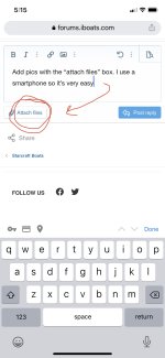

Add pics with the “attach files” box. I use a smartphone so it’s very easy
