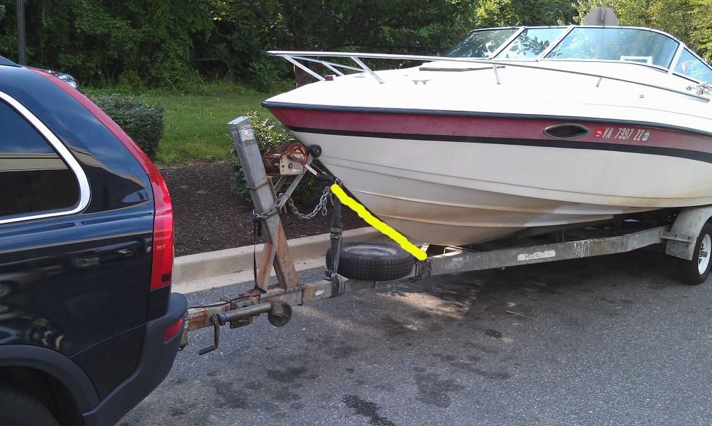

Hmm, then what are you supposed to use to properly secure the bow? I always thought that was the securing method, along with the safety hook. Never had a boat that came with anything else. I usually use rope and the sling, but always considered them backups. My sling didn't break, but sure got fatigued in a couple spots
I use a heavy cargo ratchet strap (supposed to be 10 ton break strength) on my bow. Now I wonder if that is enough?

I'd first address all the rusted hardware and that the pull angle on your winch is wrong (encouraging the bow to come up)

Think of it this way, your entire winch post sheered off, which is fairly heavy gauge welded steel. That is just slightly stronger than winch strap, and it didn't have to deal with shock loading!
Well, did it actually shear a welded mount off or did it break a couple of $2 ubolts or tear the plate they were bolted to. Most non custom trailers have adjustable bow stops and the weak point is not the heavy welded steel.

What oldjeep said about the winch and hardware.
Enough to rip the bow eye out in the event of a collision, most likely. The sad truth is that the laws of physics say there isn't much you can do to absolutely prevent the boat from launching into the tow vehicle if a collision occurs at high speed.
What is the ideal setup? I'm not familiar with a proper setting for these things, it is still the way it came when I got it.
What if I ran a safety chain from the bow eye to the trailer frame behind the spare tire? Like this.

I seriously wonder if you had a brake failure on the tow vehicle. The weight of the boat and the hill in the picture shouldn't have caused any real dangerous situation short of having to do a panic stop, even without trailer brakes.
I AGREE 100%. That is a light boat, and plenty of tow vehicle to stop it. Something had to be in failure mode with the braking system on the truck.

6,455
I think that your strap is fine. Your winch should be pulling straight, not uphill. I don't think I would want a chain where you suggest, too easy for it to bang up the bottom of the boat. Main thing is to make sure that your existing equipment is set up properly and in good repair.
The winch cable should be horizontal when attached to the bow. Your setup is the total opposite mine was when I first got my boat. My winch was all the way at the bottom of the post, pulling the bow down. When I let tension off the winch there was a loud BANG which was the bow freeing itself from the trailer. Not to mention, I had to adjust all the rollers on the trailer too.
