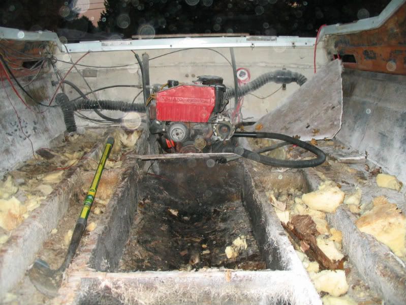

Back in August, I picked up a Raven 195cc from a local front yard for around $1800. From the outside appearance (other than some faded gelcoat) everything seemed golden. When I got it home, I couldn't get it started. I finally isolated the problem to the points system, and got it dialed out perfectly. Compression in all 4 cylinders is between 155 and 165 psi, the engine runs great. I changed the intermediate shaft bearing, u-joints, and bellows, and got the beast out on the lake 3 times before the end of the season. It ran great, except I couldn't get it up on plain and wondered why..

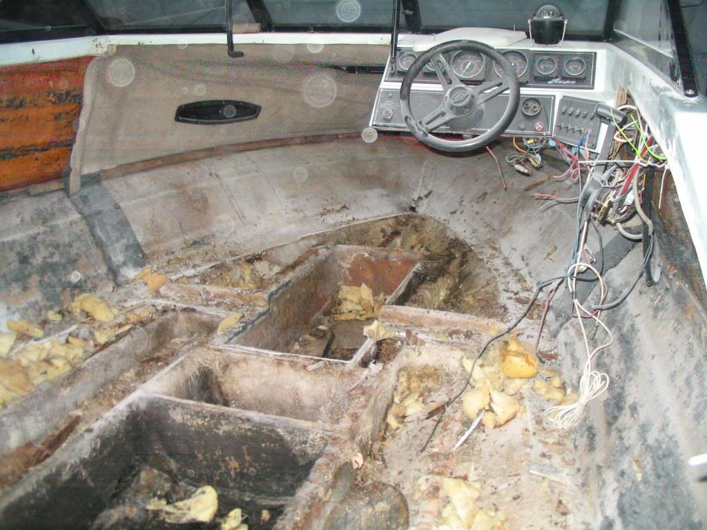

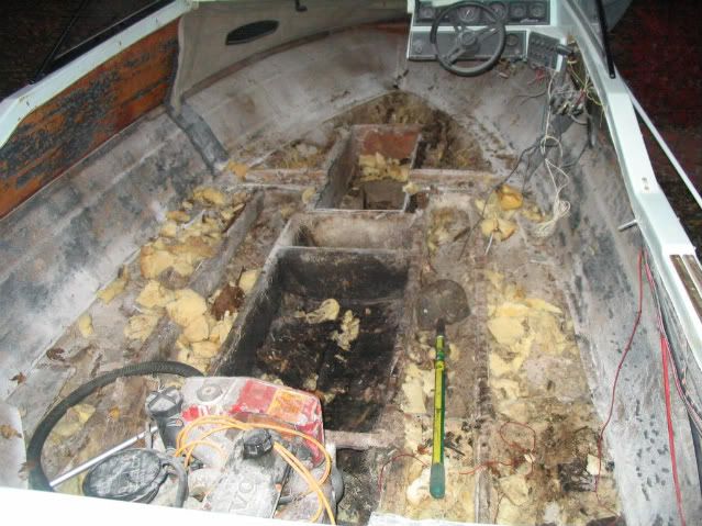

Well, the floor had soft spots, so I decided to dig into it. After cutting the chopped glass around the sides, I was able to get the floor up. No big surprise here - the deck was completely rotted. So bad, in fact, that the laminate plys of wood were paper thin and a complete (almost compost) rotted mess. As I dug into the cuddy, I found the decking even worse than the rest of the boat. The flotation foam in the bow and stern was SOAKED, so I'm currently in the process of getting all of it out. Thank God for garden tools and an electric chainsaw.. I can only imagine how much weight that soaked foam added.
The stringers and transom seem to be in surprisingly good shape, though a few "frames" and a stringer or two in the cuddy need to be replaced. As for the interior, all of the seats are in great condition (and in my basement with the rest of the boat parts, lol), the doghouse needs new wood, and the side panels need replaced. I'm not too worried about upholstery, as my mother used to be in the boat cover/upholstery business and has the knowledge and sewing machines required to do the work, I've just gotta buy the vinyl.

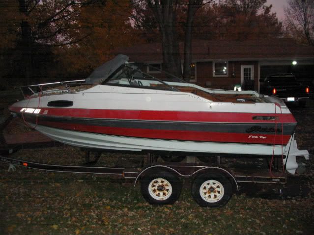

Your boat reminds me of my 1989 20ft Maxum outboard version cuddy cabin looking at it from the transom and cuddy layout, well used to look like yours, changed it to a center console. Do you have a side shot of the boat?
rucaradio
Aug 23, 2008
184
Re: My Winter Project - '89 Raven 195cc
Here's the sideshot:
Not a big surprise if it does look like your Maxim. Apparently Raven was notorious for stealing molds and plugs from other manufacturers.

I'm going foamless myself...
Please wear a respirator if you don't already...fiberglass dust is nasty.
Anyway, I've hacked the old foam out with a crowbar, big orange screwdriver, and putty knife. A 36 grit sanding disc in an angle grinder is AMAZING at removing fiberglass and wood and won't make much heat at all
rucaradio
Aug 23, 2008
184
Oh don't worry... I picked up a 2 can respirator at Home Depot for around $30 and wear it whenever I go into the bilge to hack out more floor 'n foam.
As for the foam, after spending 2 weeks of free time trying to get it pried out of the hull, I really really really DON'T want to have to put this junk back in when I've got the floor buttoned down. From what I've read, due to USCG regulations, I don't think I've got a choice tho. I'm interested in finding an expandable type of foam that is not water permieable. Is it possible?
