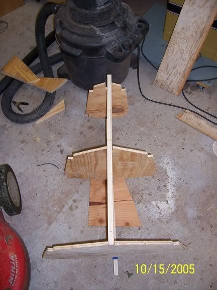

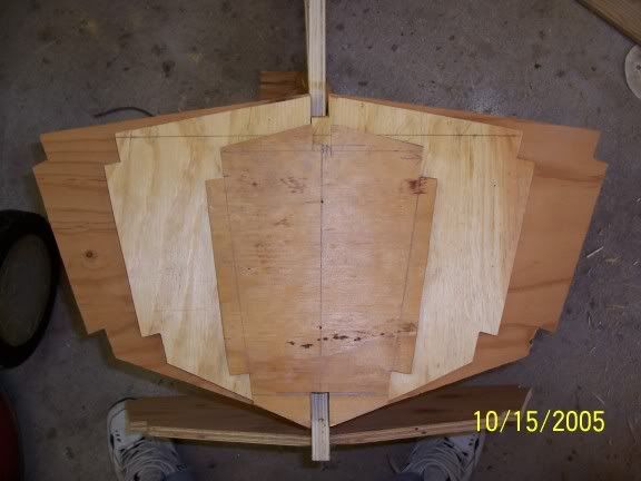

Well I have 6 out of 8 frames cut out.I was thinking that I could get away with fewer frames,but after thinking about it I know why I cant. (or wont)For one thing the plans call for 8, and I ASSume that the original designer new how to build it, and I didnt want the hassles of redesigning it.Second,after having a few frames cut,I realized that you need all of the frames so that you can attach the chine strips and gunwales to them.The strips are 3/4 inch and are going to be kinda tough to bend around.It doesnt appear to be much of a curve in the plans,but after looking at the frames,it is a pretty good curve.I think that 1/2 strips would have been fine for this boat.(more than fine actualy)They would be easier to bend and made it a little bit lighter.I would change it but I already have the frames notched for the 3/4 strips.I plan on having the other 2 frames done today, and then starting to make the strongback as well.The plans call for a 2x4,but I havent found one straight enough to use,and it has to be STRAIGHT.Since you are building the boat based on the strongback, if it is off then so will your whole boat be.I am going to make it out of plywood so that I know it will be straight.I might even make a template for it :D Once the frame and strongback and templates are done, then the fun begins!I also plan on making frame number 4 and the keelson out of plywood also.I have enough mahogany to make them, but I am too lazy to glue up all the boards that it would take to do it!Now,to keep the 3 stooges happy here are the photos!<br /><br /><br />Three frames:<br />
<br /><br /><br />Top view<br /><br /><br />
<br /><br /><br />side view<br /><br />
<br /><br /><br />other side view<br /><br /><br />
<br /><br /><br />I put the frames on a piece of ply just to see how they were going to look.A TEMPLATE if you will! mlm :p mlm !

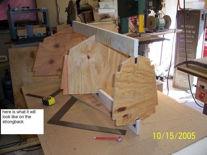

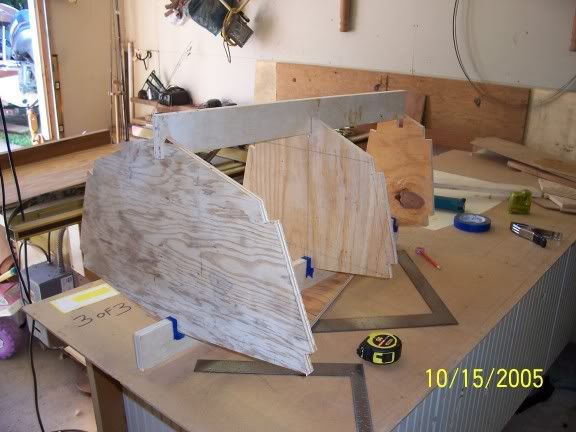

Ive got the strong back complete!I have the supports for the frames attached to the strongback.I ended up making the strong back out of some plywood that I had lying around.It worked out rather well, and it is pretty straight.ALOT straighter than it would have been if I would have used a 2x4 as the plans called for.Lumber isnt what it used to be, from what I have found.Now if I hadnt ended up spending the past day and a half YAKING (pun intended) from some bad taco bell, I might be farther along.
CalicoKid
May 27, 2002
1,599
Re: My YAK by CPJ (aka YAK LIGHT)
Nobody believes you without pictures! :D Using plywood for the strongback is a great idea. It will also probably resist bowing and twisting with the weather much better than a pine 2x4 if you're building in an unheated garage. Also, you've got quite the workshop there, where do you keep your cars? :)
