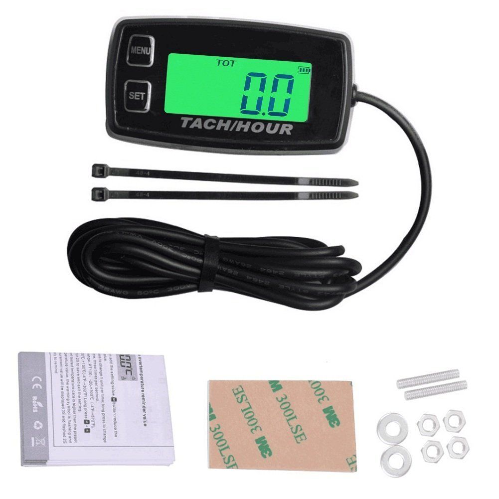

I have a 4 cyl. 2 stroke on pontoon boat, it has no tach so I figured I would buy one
The ones on ebay and amazon like this see above picture
now the issue is this
All reference this
Applicatve Engine Types:
2 Stroke of 1 Cylinder/ 2 Cylinders/ 3 Cylinders/
4 Stroke of 1 Cylinder/ 2 Cylinders/ 3 Cylinders/ 4 Cylinders/ 5 Cylinders/ 6 Cylinders/ 8 Cylinders/ 12 Cylinders/ 16 Cylinders/
These all (multiple brands/rebrands etc) leave my engine out?
Any ideas that won't break the bank? want to make sure it is revving they way it is supposed
52,369
the wire gets wrapped around a spark plug wire. they work on anything. its a knock-off of the tiny-tach. they even work on snow blowers, lawn mowers and chain saws.
so long story short. if you have a spark plug wire to wrap the tack sense wire around, it will work.

Okay great, the not listing 4 cyl confused me, i will order one
again thank you!
Sea Rider
Sep 20, 2008
12,345
Or buy the Hardline up to 8 cylinder engines hour/tach model HR-8062-2. Follow easy installation procedures.
