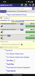

52,838
It's a $23 carbon canister and $60 pump.
Look on rockauto.

flashback
Jun 28, 2002
4,391
Look on rockauto.
My guess is he doesn't want a DIY, although that looks like the solution. You can get granulated charcoal at the local pet store. The big shots in Germany won't care
Might even authorize it.
