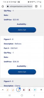

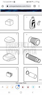

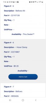

According to Volvo Penta site looks like I have 3 bellows total. What is this 3rd one for? Part no: 3587641
Looks like 23075752 = U Joint Bellow Kit
3850426 = Stern Drive Exhaust Bellow (the one that I am missing?)
3587641 =Another Exhaust Bellow?
My TSK: SX-MHP according to my notes from previous owner.
There are different part numbers though from the DP-SM vs SX-MHP?

The third bellows might be the one where the shift cable enters the hose that guides the cable to the drive.
alldodge
Mar 8, 2009
43,710
^^agree exhaust tube
Can either install a bellows which exhaust exits at the drive, or the tube which exits at the transom
Lou C
Nov 10, 2002
13,878
Looks like yours came with the exhaust tube instead of the exhaust bellows. And yes there is a small bellows at the top of the shift cable tube inside the boat where the shift cable comes out. This one normally is part of a a new shift cable assembly, but probably be replaced separately if it starts to come apart.
As far as what you should use, tube vs bellows it’s hard to say really. Might have to ask your Volvo tech & see what they say.
The ujoint bellow is the important one and should be inspected every year and replaced as soon as you see small cracks in the folds.
