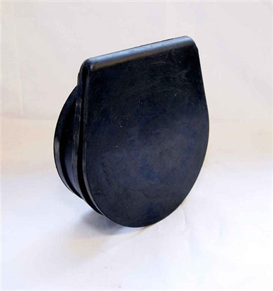

Other things I’m wondering about are that swim platform adding too much weight and the lack of any kind of flappers. I have seen one Volvo SX equipped boat that had a similar problem, this was a small boat with a big engine (Four Winns 180 with a 5.7 V8)
He wound up trying this with success: removed the VP exhaust bellows and fitted an inboard style flapper to that flange. You’d have to measure the exhaust flange diameter to get the right size.

what do you by an inboard style flapper over the exhaust housing flange? I know where the Exhaust bellow is on my boat I believe I posted a pic of it earlier in this thread but what else would go there?

something like that, to prevent water from washing up the Y pipe.

you don't have an exhaust bellow that's an exhaust tube. remove the tube & replace with a flapper, if it fits ok over the tube & won't come off you could do that as well...

how the hell is all that water then getting up into my engine from such a small diameter hole. that is crazy. I think a flapper there would definitely help.
Something like this would be perfect. Link here. It can go inside the tube so I won't have to remove that and it would add additional protection? Any negative about using something like this? maybe higher manifold temps? or it could restrict the exhaust a little?

that looks like it might work. As far as how water gets into the engine, keep in mind there are really several sources....the engine while running has to have a steady flow of cool water pumped in by the impeller, naturally this gets exhausted 100% out the elbows, BUT, if reversion is happening, some of it gets sucked back up into the cyls. THEN, there's back flow that hits the transom of the boat when you slow down, and can run up the Y pipe. So there are actually TWO different sources of water that can wind up in a cylinder. Reversion, and back flow.

Also Scratch that one I sent you I took measurements and that one I sent fits into a 4in Exhaust tube. The ID of the exhaust Tube is 3" and the exhaust tube after the risers are 3.5"ID so I think my only option for that is the flapper you suggested and to remove the OEM Exhaust tube and swap it for the flapper however if I do this then there will be no tubing lined up to the back of the outdrive but I guess in theory that won't matter since the back pressure of the exhaust at higher rpms will keep the water out of there.
I can start with this flapper for now and test that out - 3" Flapper
