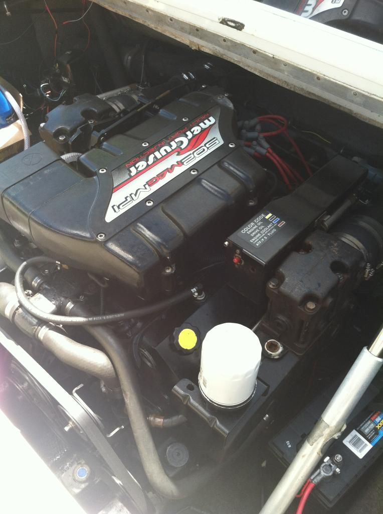

couple pics i grabbed the other day to hopefully help:

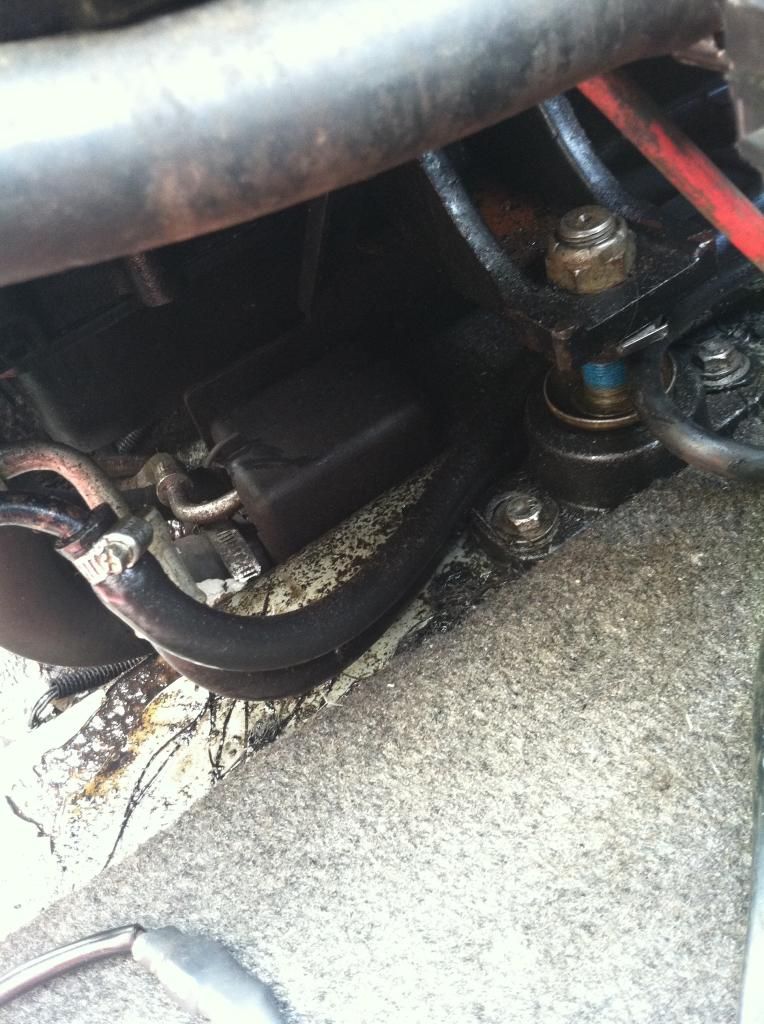

is this the fuel cooler that was referred to above?:

Have him brush up on his knowledge on the PCV hoses routings with this engine model before get's to your boat. Something doesn't look exactly right to me for some reason. I can't pin point it for you though.
as shown in my earlier pic in this thread both breather tubes had PCV valves and were T'd together and run into the intake manifold, but i have since corrected it to have one go the the flame arrestor without a PCV, just an elbow.
i did run it this weekend, and found that about 4000 rpm sustained is when the oil starts coming out. i got a slight whiff of it and got out of the throttle immediately, and checked under the sundeck afterwords and it did slightly haze the flame arrestor and the mirror on the bottom side of the sundeck. changed the oil with some 15w-40 last night, and the oil that came out of it felt pretty thin, so we'll see if that helps.

I would suggest removing the PVC valve all together. Connect the hoses together with a Tee and have the open end of the Tee position under the arrestor. This is how mine is and I don't have much issue at all with oil. It does appear your engine is wore more then mine.
Edit: There should be a S/N plate above the starter

i looked for that earlier this year per your reccomendation in your first reply to this thread, with no luck:
..as far as the serial number, i don't see said plate anywhere around there either; is it something stuck on the block or is it like an axle differential tag where its connected by a single bolt? that was the first place i looked, and after not finding it found the forementioned merc document about it being stamped onthe block. i'll look again.
i need to check the starter ground anyways, so i'll give it a look yet again.
