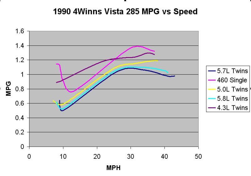

If you do a little research on measured fuel consumption versus what other boat owners claim for mileage, you'll learn that the actual data shows that engine size is actually very insignificant. The size and weight of the boat will determine what kind of economy it gets. Boattest.com has lots of info on different boats, the Four Winns archives JoLin referenced are also excellent.
If you think twin V8's will double your current fuel consumption, then the V6's should make you very happy. You'll get about 1.2 MPG with the V6's instead of the 1.1 MPG you would get with the V8's. That'll only be about 1.9 times your current consumption instead of double. :)
Gasoline produces about 11HP per hour per gallon of gas. It will require 20 to 30 gallons per hour of gas (200 to 300 HP) to cruise a boat the size and weight you are talking about. Doesn't make a whole lot of difference whether you burn it in a little cylinder at a lot of RPM or a big cylinder at a lower RPM.
The nice thing about having excess power is that if you do want to take more people out, that excess power is there for you if your throttle hand wants to use it.
The Four Winns archives had performance info on a 1990 285 Vista, 28' long with a weight of about 7400 pounds, probably very similar to a 1990 Cruisers like you're looking at. I graphed the data for the twin 4.3, twin 5.0, twin 5.7, twin 5.8, and single 460 engine packages they showed. As you can see, at 25 - 30 MPH, you're going to get around 1.1 to 1.2 MPG with twins no matter what engines you have. The state of tune of your engines and how hard you hammer the throttle will easily make MUCH more difference than the .1 MPG difference you see due to motor size.
Your best fuel efficiency would actually come from using a big single, primarily because it only has to overcome the water drag of a single outdrive.

In the case of my boat, for example, the consumption penalty for twin FI 5.7's over the FI 4.3's is about 40% @ 3000 rpm... 20 gph vs. 14 gph. At higher rpm's the V-8's do a better job of moving the boat, and the difference is less. 20% at 3500 rpm.
Why compare different size engines at the same RPM? The bigger engines are moving the boat faster at the same RPM, water drag goes up as the square of the speed. A more meaningful comparison is to compare engines at equal speeds.
According to the 1997 278 Vista data, on your boat at 3000 RPM the 4.3's are going 26 MPH (15 GPH) while the 5.7's are going 32 MPH (21 GPH). At 3500 RPM the 4.3's are doing 32 MPH (20 GPH)while the 5.7's are doing 38 (24 GPH).
If you look at both engines at the same speed, at 32 MPH the 4.3's are burning 20 GPH at 3500 RPM, while the 5.7's are burning 21 GPH at 3000 RPM. 1.60 vs 1.52 MPG, about a 5% difference.
If you want to go 38 MPH, the 4.3's are burning 23 GPH at 4000 RPM while the 5.7's are burning 24 GPH at 3500 RPM. 1.65 vs 1.58 MPG, about a 4% difference.
That's a 1 Gallon per Hour fuel consumption difference at equal speeds in both cases. 1 GPH at cruising speeds is pretty insignificant in my boating world. But if it makes you happier to think that you're getting 40% better fuel economy with V6's, keep on boatin! :)
