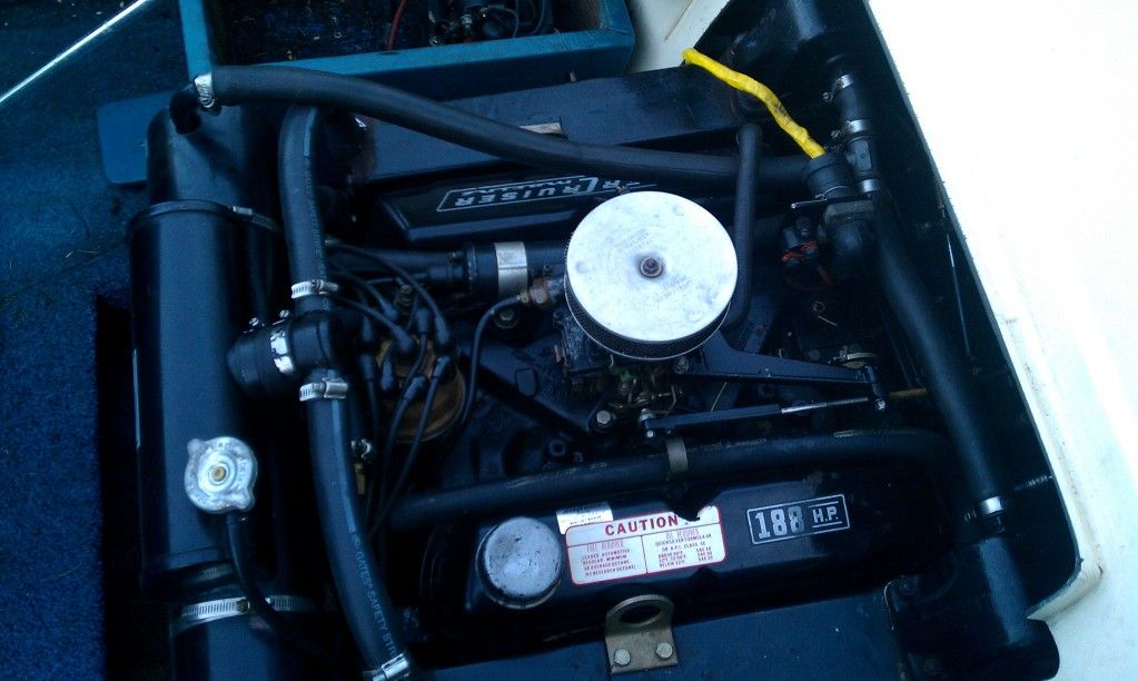

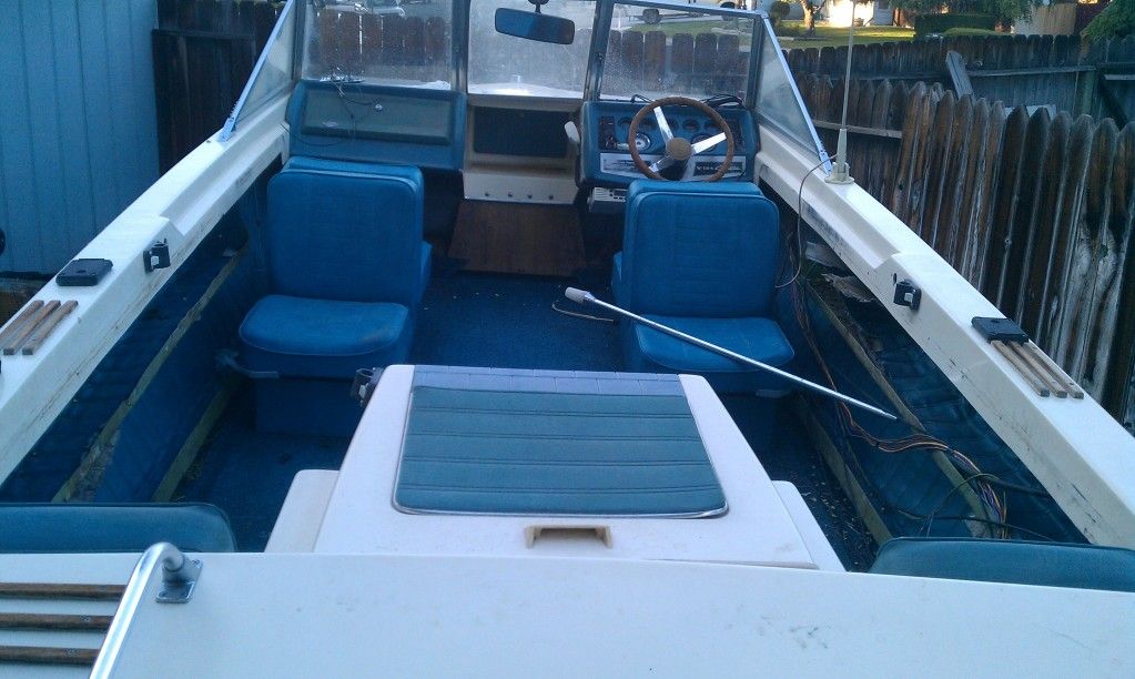

A little update:
So I got my wiring all squared away and tore out the old carpet. I also siphoned off 7 gallons of some the nastiest fuel I've ever dealt with...looked like rotten orange Crush and smelled like linseed oil. In the process of getting every bit of fuel out of the system I twisted off one end of the line that goes from the fuel pump to the carb as well as tearing rubber fill tube from the gas cap to the tank in half.
I'm hoping I can get the engine to turn over this coming weekend. Found a rad shop in between two boat shops that deals with heat exchangers on a regular basis. I hope my HX is repairable.
I figured I had better add a few photos:
Doesn't look too bad for a "free" boat.
Carpet gone.
Harness squared away and sans heat exchanger.

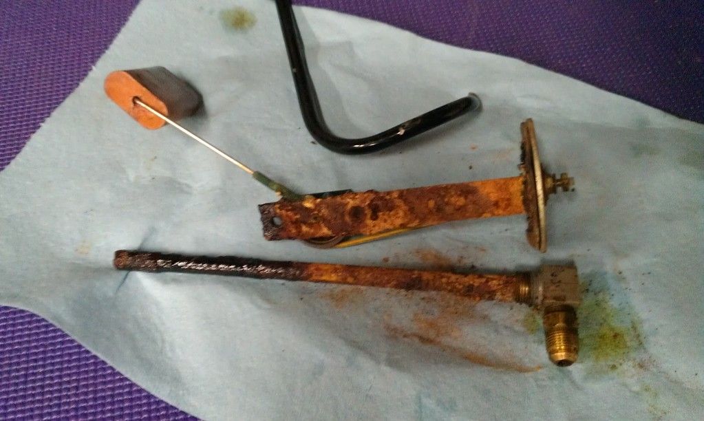

Oh yeah, the tank is a rustier than a rusty trombone...A little bit of saw work and some cursing and I was able to pull the tank out.
I couldn't get a good pic of the tank, but here's one of the sending unit and the pick-up tube:
If these look this bad, you can imagine what the tank looks like! The pick-up tube is actually sealed shut, The compressor won't even blow through it.
I guess I will be shopping for a plastic tank...unless of course I figure out a way to salvage this one. Is that POR15 as good as they say it is?

Forget the POR15 or any other product with that kind of corrosion. A new tank and sender is the ONLY way to go.
