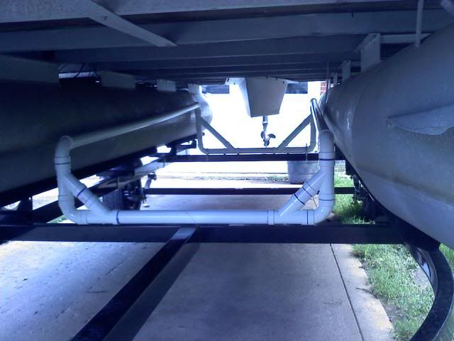

If all is as it should be a photo will appear of the guides I had built or my trailer. Made loading a dream instead of a nightmare.

Re: New Toon owner needs advice retrieving boat onto trailer
Inside gides work the best
