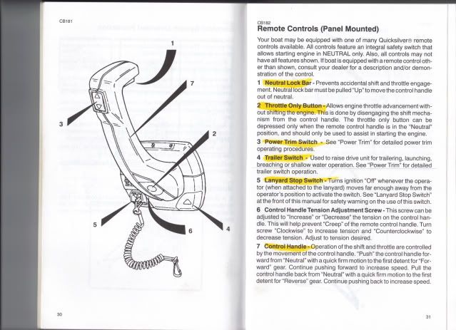

Here ya go xavi08. Scanned this out of my manual.;)

Pierutrus : thats exactly what i need, the manual! thanks for scanning that page for me.
