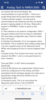

I was curious if this converter would take care of everything. Seems to easy haha

I came across this info last night when researching, it was back a few years.
