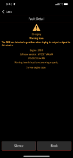

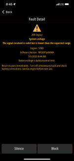

I am getting a couple warnings from my smart craft monitor app. I will post pictures.

Here are some things if tried. I was able to get my hands on a used ecu with all matching numbers, Iv also replaced the main relay with a new one that Iv had in the shop. Also tried a new battery and switched out the main power cables coming in.
If I hook a connection light up to a ground and touch one side of the injector plug it does light up when key is on.
We have spark on all cylinders
I’m getting warnings on my smart craft mobile
“ critical low voltage” and “ecu has detected a problem when trying to output a signal to this device”
The only other thing I can think to replace would be the starter solenoid? Any other suggestions? This motor was flooded at one point but have had it running for a few min sense.
