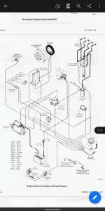

no, the boat uses a 1.5 ohm coil requiring a balast resistor for running and gets full 12 volts when cranking via the I/R terminal on the starter. that is the way the boat is wired.
Whoops. Everyone forgot that this is a 170. The 12v coil voltage is supplied by the slave solenoid, not directly by the starter.

Now the colors make sense! If the Pur/Yel wire looks good between the coil positive and the slave solenoid, then run a jumper between those two points just to make sure there's not a bad spot somewhere you can't see. If the engine still won't start there must be something wrong with the solenoid, right?

I’m more clear on where to look now. I just couldn’t locate the wires being discribed, causing me more confusion. It’s also somewhat difficult to lay across the engine and visualize where the wires from the slave solenoid to the starter solenoid go exactly.

I checked the + terminal on the coil with key on. Read 12.5 volts. I was checking the slave solenoid & I noticed the kill switch that I removed a yellow & green wire from earlier this week, I neglected to connect both ends. So I re connected as in the picture.
Before doing anything else I turned the engine over with the key. I thought I saw the spark plug tester spark, it may have been a weak one.
I connected a jumper from the coil to the slave solenoid purple & yellow wire. Turned the engine over & it cranked up, the key would not turn it off so I quickly removed the wire. Actuality the 1 st time I connected the wire the engine turned over with just the wire connected!
Anyway, now it fires up like it should do normally.
