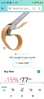

Okay..
Now it's your choice from WAY to many opinions from above.

Thanks for all the replies everyone. I didn't know that there was such a tool for holding the flywheel, but after you told me I ordered one off Amazon. It will arrive this evening and I'll go and get it sorted. If it fails I'll try a screwdriver between starter and flywheel.
I just calibrated my torque wrench so I should be good to go.
