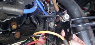

I found this ground wire and couldn't figure out where it came from. It does have the same size ring terminal as the coil post. Is that supposed to go on the negative post of the coil? Not sure if the wire is even long enough to reach coil. I put it on the starter solenoid bracket. It was NOT there before I started looking at an old pic. It comes out of the harness where the starter solenoid wires come out

All grounds should be well grounded. Don't know if the bracket were the black wire is connected has a good ground or not. The wire might be for a Mercathode which doesn't look like there is one,
