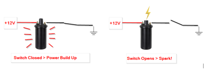

First some fundamentals:
The Ign Coil has +12V on the + terminal (so when the key is on / start it has power) and on the other side (the negative terminal) is a switch that opens and closes as the motor turns. When the switch is closed the coil ‘powers up’ and when the switch opens it releases that power as a spark for the plugs.
  • If the switch never closes, there is no build up of power and thus no spark.
  • If the switch never opens, there is no release of that power and thus no spark.
See mock up below.
Your negative terminal should have 2 wires going to it
  • One for the switch
  • Other for the Tach
It’s possible for the Tach wire to short out overriding the switch from opening, thus no spark. This is why the first step in the Troubleshooting (T/S) guide is to check that wire. No need to unbundle it from the wiring harness, just use a Multimeter. But easier to simply remove it, leaving only the switch wire connected.

What is going on with your situation is that the switch wire from the module is not connected to the coil.
Thus, your mission is to find it, because its there unless it got cut off somehow.
