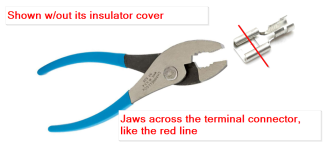

A loose connection like this can sometimes work (like its tight) and sometimes not (choke will not fully open due to poor connection). The point: post watching what it does, if the choke does fully open this does not mean the loose connection will cause it to not fully open on the next cycle. In other words, you can get a false indication all is good.
You may be well familiar with these spade type connectors, but if not, taking a pair of pliers and gently squeezing on the rounded ends is the way to tighten them up. See pic for a mockup of what I mean. Be careful, only a little squeeze is needed. Push it back on and pull it off > does it feel tight? Good, do it again to help clean it up and get a good connection. Still loose? Pliers again with a little more squeeze.

That was my plan, gonna give it a go tomorrow and see how it runs after words, but if choke was wide open the whole time it would explain why my plugs were black and was running rich, I hope.
