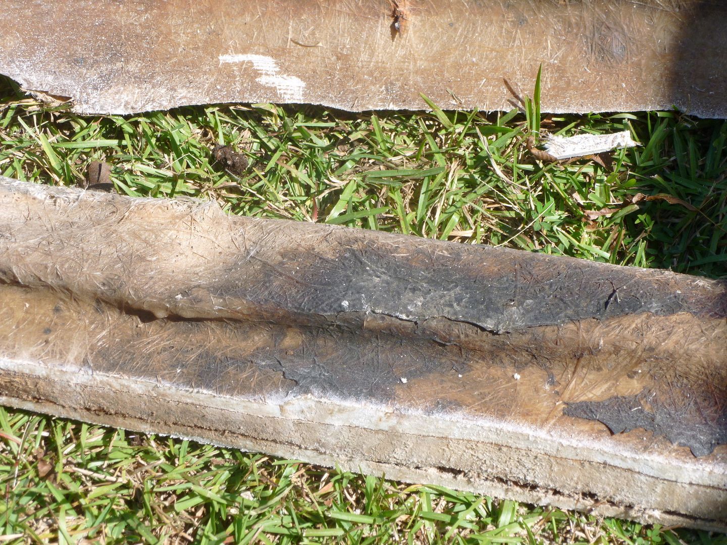

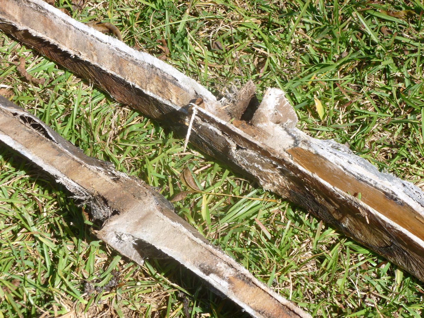

here are the stringers cut out, i presume this boat was built on a saturday and the guy was not pleased he had to work that is the only thing i can think of to lay the stringers so crooked and to had different size wood for the stringers and the bulge in the fiberglass.... notice that the wood was really in great shape from the bottom to about half way to the top of the stringer....any comments or suggestions would be appreciated...the rubber pulls up easily if it is thick but not if it is thin...

The sagging/air pockets in the fiberglass that covered your stringers isn't uncommon, I've seen this in several restorations. Those factory boys were going for speed, not quality.
