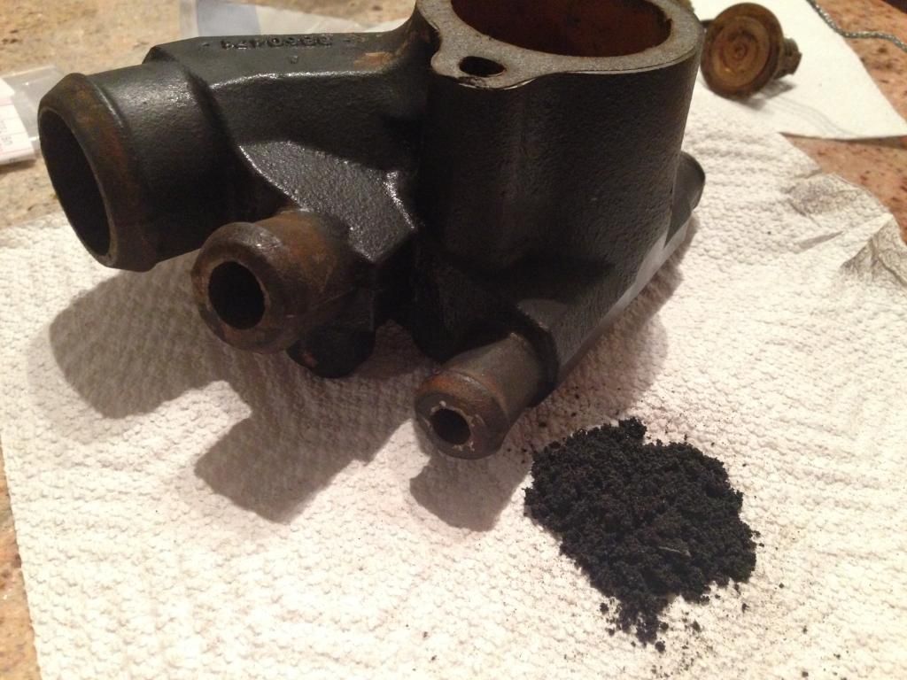

So got the tstat housing off today and tstat seems fine. Tested it in a pot of water along with a new one that I picked up just in case and both opened at 160 and fully open at around 170 then closed fully when I took them out. So I turned my attention to the housing. The housing is brand new as is mostly everything else. This is what came out after running a abraded wire through the bypass port and through the manifold ports....
It's like sand?? At first I thought maybe the old impeller disintegrated before i got into the housing but that's not possible because before I replaced the water pump with a new pump and impeller, I put a new impeller into the old pump before I ran it. Maybe this is just leftover gunk that was in the out drive, oil cooler and hoses I didn't replace, before the water pump and plumbing up tot he tstat housing? Anyway, all ports are cleaned out and there's nothing that is blocked so hopefully this will do the trick and get her up to normal operating temp.

I had the same problem with my last boat. Found out I had a clogged bypass port in the tstat housing, clogged with small piecies of an impeller.

That sand could be left over from the casting that was never removed during manufacturing.

So finally go around to re-installing the tstat housing (moved to new place and have been spending most of the summer with home improvements instead of at the lake :facepalm:) after cleaning it out. Fired her up an she warmed up beautifully to about 160 and stayed there. Mani's and risers felt cool to the touch and all good. Now just gotta find the time to get on the lake again.
