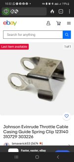

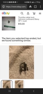

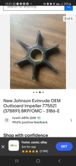

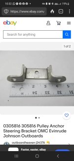

I ordered these parts, I went ahead and got the impeller is there anything else I should do while I have the lower unit off?

I got a mile master it's not evenrude but close enough, I got out bid on a freshly rebuilt cruise a day by$15 I was so mad. But I found this one for a good deal that had the connector with it in decent shape. I figured I'd give it a new paint job. Already sanded all the rust off everything on the inside and cleaned it up and put new custom leather seals on it. This boat I think might have sort of the steering your talking about, it has a drum behind the steering wheel with channels through the middle of it where cables are ran from there to a series of pulls. I was thinking about changing it out but it looks brand new. Any idea how safe they are?
39,516
Some folks use " clothes line " on them .----I looks the same but is NOT the same.----Use tiller cable from your local boat shop.-----They are ok for up to 40 HP or so.
