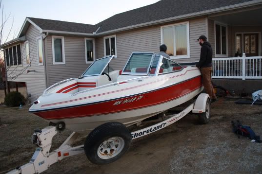

Forester was made in MN, they are no longer in business, but they are a still common up here. I'm taking the boat out on the lake tomorrow. I've got pictures, should I post?
Joshua Nichols
Lieutenant
Jun 29, 2009
1,431
Re: OMC Cobra 4.3 Transom Shift Cable inspection quesiton+
of course... We all love pictures

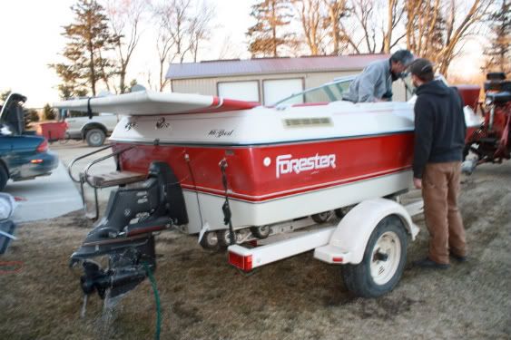

Wow it's a good looking barge..
Can't get those manifolds anymore... There are aftermarket replacements...
It has a roller trailer.. Some people love em.. Some don't..
You are right looks clean a whistle..
If everything runs smooth, I don't really see it to be bad..
Hard to find a boat with a V6 newer than a 90 for 3k..

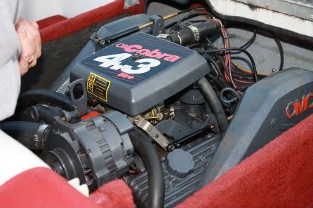

Well I posted a bit of this in the other section of the forum but I will consentrate more on the engine here.
Shifting was extremely smooth, all gears forward and reverse. I wasn't quite expecting the power and it did make me a tad bit nervous. I wanted to open it up full throttle, but at 45 mph, that was about as fast as I felt comfortable and I had it almost there, the engine was purring and didn't sound at all stressed.
I tried all gears several times. The mechanic said the engine was in excellent shape and I was able to call the mechanics where it was serviced most of its existance and they said the owners were real fastidious. Cable housing looked great as did major points.
