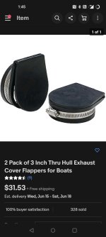

What if I stick one of these on the back of the boat where the exhaust bellow goes. Renken you said home made. I've never seen these below the water line. Guess I'd just have to try it out and see how it behaves when I'm stopped.

I got this flapper to fit on the transom exhaust port. Taking it out tomorrow. Think it will work?

Got it out this weekend. Two days on the water not one issue. Thanks guys
