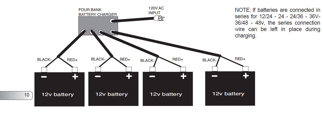

Here is another link from another charger manual. Look at the note to the right.

Interesting -- thanks. My charger is on the boat (along with the instruction manual). Wondering if mine has that configuration option.

Well hell, if all else fails, just look in the instruction manual (just got the charger today).....
Quote from the Minn-kota manual::
Each output bank is independent and isolated from one another and the AC input. The Minn Kota charger can charge independent batteries or combinations of batteries hooked in series or parallel without disconnecting the batteries from any switches or wires / straps joining the batteries.

Can't get much clearer than that! (Points to Bruce and to manuals...)
