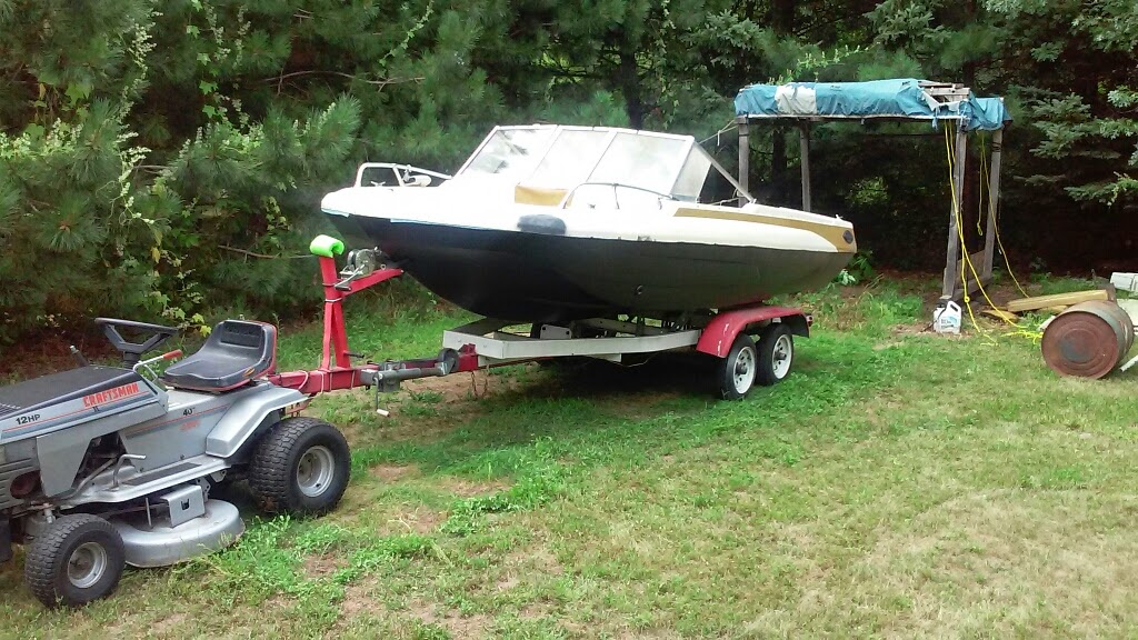

Well, Impatient as always, I couldn't wait. I flipped the hull after work. I didn't get any pictures of the flip, but it was relatively uneventful. The 1 ton chain hoist worked great on the back of the boat with a swivel and a chain, the front I ended up having to use a swivel and 4 pulleys and rope which actually worked quite well.
Next step is putting the backing strip around the edge of the hull for the rub rail to screw into!

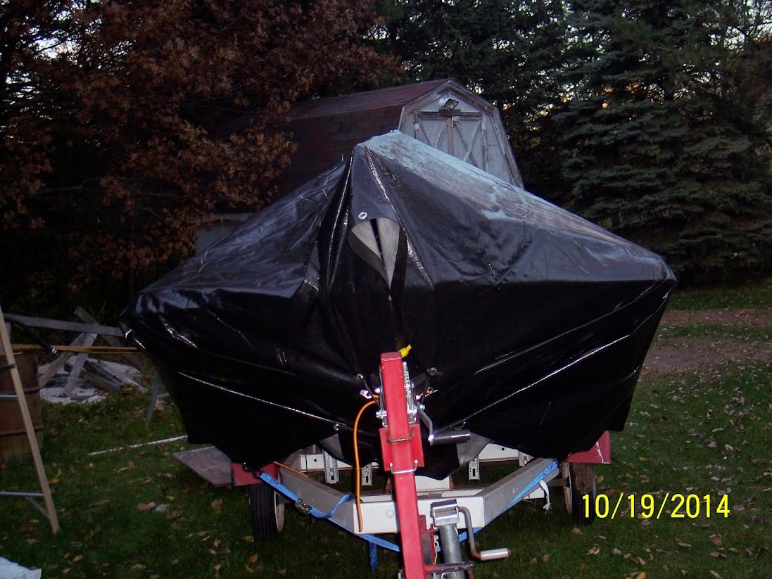

Well, with winter closing in and my level of procrastination, I figured I'd better figure out my storage solution for the semi long term since the boat is now in the position of being a "collector" of water/snow/ice/leaves over the winter. So, I picked up a good 6 oz tarp ( 12x20 ) for $30 and some PVC tubing along with a 20+ foot piece of metal fence railing. I figured I had 3 extras laying around doing nothing and they worked well for the my temporary shelter to paint the bottom of the boat, it would make an excellent "rib" for the cover. I wish I had documented some of the things I did in preparation, but you should be able to figure out the gist of what I did in the final product.
Looks pretty sturdy and the black side looks pretty good considering the boat is going to be black. It was either that or silver, and I like the idea of the black helping to keep the snow off the boat. We'll see about that in a couple of months, right?
So, this is how I support the "rib". The center supports are 1 1/4" PVC tubes, whereas the front and rear supports are 1" because that is what I had laying around from the support system I had made for my smaller boat. That system sucked, this system rocks. I had to use a forstner bit to open up the "T" to allow the rib to run through it, but I like the snug fit in front and back...I don't have to worry about them slipping out of position, especially since I had my boy help me bend the pole to fit the contour of the boat with the windshield on it ( not currently on the boat, so hopefully the profile will be right and I can use it unmodified when the boat is complete. I used a total of 4 ea. 1" and 1 1/4" T's along with the lengths of piping. I did however use 90 elbows at the bottom of the center supports to keep them from slipping away from the weight of the snow once it's pushing down on them.
I tried to keep this as simple as possible.
30Q0q5yDruvDNI1TGQC3NJF4DaLEM5_lDEzvE_Slu08=w1097-h823-no
I kept the front pole just poking in front of the boat and used a 90 degree elbow used on a garbage disposal to round off the end of the pipe to keep it front tearing the tarp. In back, it's so loose that all I had to do was cut it off and package up the extra material. the nice thing is that there is enough of an opening to allow ventilation from front to back, but enough closure to hopefully keep the majority of any snow out of the boat.

And good timing too, looks like it's going to get put through it's paces here on Monday-Tuesday as we are slated to get 18" of the soft stuff. Kind of a bummer though, there's a lot of us still trying to get our fall projects finished...

Hi Red,
Glad to see you poking around and that you got it all tucked away for the coming winter...hope it holds up solid against Ma Nature...
Oh yeah, and keep taking it easy on that back of yours...you are gonna need it come spring time.
All the best!
