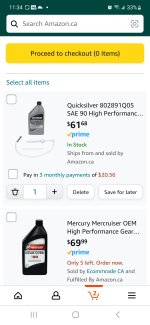

Just to put things in proper perspective. I did not specifically complain about $30 a litre but when Amazon tries to suck me in for $61 a litre a post on here is warranted.
