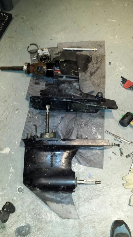

i was able to get it with a 2x4....bearing came out with it, oil in the u joint boot

the bearing surprisingly isnt seized, it spins... its definitely bad, but it spins. and the ujoints are just surface rust, they move perfectly with no binding
50,487
your input shaft seal to the outdrive is shot. because the bellows was shot. which is why the oil reservoir was empty.

im planning on taking the shaft off and taking it to work and trying to press the bearing off. il see what kind of condition it is in once i get it off, as of now the ujoints are fine. i just gotta figure out how to get everything apart to get the shaft out of the upper

I see trouble with that shift shaft sticking up.
Listen, if you pried the units apart I want you to STOP right now and get the manual before you damage it beyond repair.
Handel the lower unit like a grenade with the pin pulled, unless you really want to do a full teardown. right now your unhooked from this.
and if it pops off the bottom pin your FUBARD

i didnt pry it apart, the shift shaft cleared the upper housing just fine when i pulled it apart, there is a ~2-3" cutout in the upper for that whole section to slide out

It was pulled up , that shaft dosent move splitting the drive. From the water pump wear plate ,its 3 inches to the top of the shaft. That aint 3 inches
