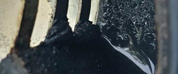

I had an overheat in 2019 with the batwings, left side. We were on plane and I smelled something burning (rubber coupler in the exhaust system, prob), and the water temp was up some. I stopped and pulled the cover, and it was crackling in there. Spooked me enough that I discharged the extinguisher briefly (not necessary, prob).
Took it back to the dock under less power and replaced those with a complete GLM system. Runs cooler with that than the original manifolds, and they were considerably corroded inside. Not necessarily suggesting GLM, but it's worked for me so far.
Lou C
Nov 10, 2002
14,000
You can see that the outlets on these are pretty small, I had them on my 4.3 as well, after 5.5 seasons in salt water they looked like the one on the right. I had 3 sets of these on my '88 4.3 here in the salt you have to change them every 5-7 years, or else, you have overheats, or a hydrolock if they rust though. I replaced them with the later style exhaust using Barr Marine manifolds and elbows and the V/P aluminum downpipes and rubber hoses.
the first thing you should do with any new to you boat is change the raw water impeller, that is a maintenance item usually every 3 seasons, they do wear out and take a set, and won't pump water that well. The one in your pix is no good it probably was at least partially responsible for the overheat. The other possible culprits are the stat and clogged manifold outlets.
the rust you see there in the thermo housing is typical, you can clean it up with wire brush, and ream out the water passage hoses with a coat hanger.
the manifolds, I'd take em off and check to see how the water outlets look. Those can be reamed out too if the clogging isn't too bad.
You're in freshwater? If so that's not so risky, here we just have to replace them. I replaced the thermostat housing and manifolds 3 times, in 20 years in the salt. The problem with the one piece design used by both Merc and OMC was that they had trouble getting consistent wall thickness, some were fine and some were very thin in certain areas and that could cause a hydrolock. I never had a problem with mine other than having to replace due to salt water use. I do like having the 2 piece system because I can remove the elbows to inspect, might only have to replace them after next season, I will see when I check the manifolds by filling with acetone.
You can see how much larger the water passages are on the 2 piece units.
