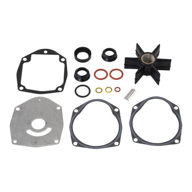

So you think it was just an impeller failure? No way the stuck thermostat caused this? Should I get the whole kit with the cover and orings or just the rubber impeller? I already ordered the merc impeller.
No the thermostat would have no bearing on the impeller. Even with thermostat closed the cooling system is constantly flowing cold water to the exhaust system otherwise your manifolds, elbows, and rubber components in the drive and exhaust would melt. So the impeller always has a path to discharge water unless the manifolds elbows are clogged.
This is the kit I use, available from many sources.
