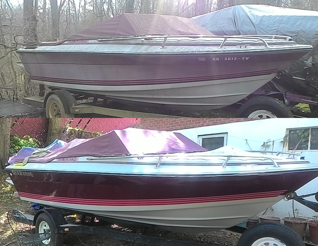

1974 Caravelle CIV 19B, heavy oxidation with a nice red color underneath.
I'm looking to buff her back to her former glory (my neighbors will hate it less in the driveway) but everything I'm finding on materials includes like 10 different potions, multiple polishing attachments, 5 sand papers, and 10 weeks worth of work, etc.
Someone that has done this before on a budget, can you let me know the "Must Have" materials to successfully remove oxidation, and leave out the extra components that are what I'd call "Nice to Have".
Not looking for a perfect professional looking job, just want her to look like she has been used in this decade.

Given that the boat is 100 years old (well maybe not quite that old . . . ) you want to consider how much gelcoat is left under the oxidized surface. I would start with a small area and maybe go with 400 or 600 grit wet sanding, then maybe switch to rubbing compound then a polishing compound. If that works out well, you can expand to the entire boat.

red boats tend to fade to pink, and by the time you sand thru that to get to red, it doesnt take long to fade back unless you go a bit deeper. many times you may find with older red boats is someone else sanded and buffed a few times already and you see fiberglass coming thru
your boat is almost 50 years old, my 31 year old red...er...pink boat needed a complete re-gel to bring the color back. I had did a sand and buff when I bought the boat in 2011 and again prior to throwing in the towel and re-gelling.

Thanks fellas, Ill start with a wet sand on the lower corner of the transom and see how we look. Boat sat for 20yrs before I got it, repowered the engine and now I need her to shine. I dont see any signs of prior buff work and where the cover protected the sides you can see what it should look like, so I should have some gel to work with but end of the day a new gel coat is the way to go. Just not there yet and want to save the neighbors some headache in the mean time.
