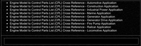

For the OP, if you have a certified Cummins tech working on your engines, they won't use INSITE on a non-electronic 903. But they can refer to the Control Parts List cross reference for ordering parts for the seven different marine 903 engine configurations. Those CPL's cross reference with the identical configurations used in other off-road equipment for construction, industrial, generators and pump applications. You will not find a cross reference in automotive with off-road due to differences in emission calibrations for the pump, governor and AFC.
