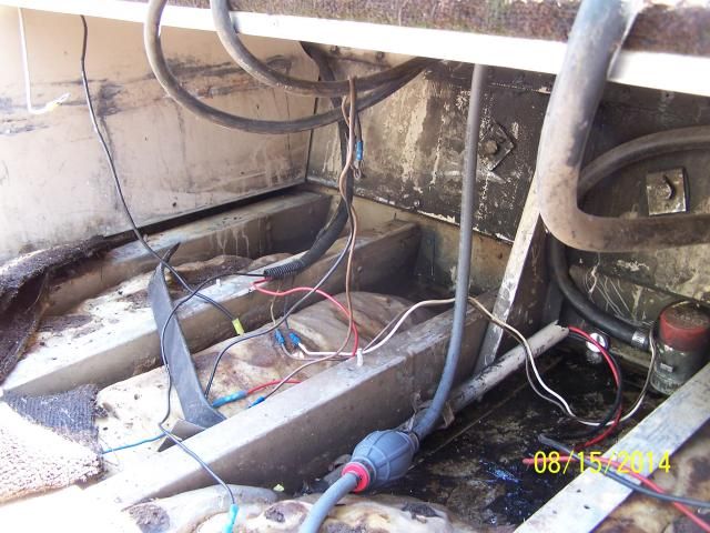

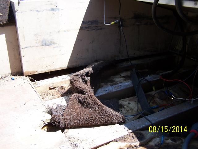

Here they are, a couple pixs of the stringers where I removed the plywood.
The bottom picture shows a pcs of the old carpet that was left when th PO redid the decking. That is also a part of this where I will need to slip the plywood under and into that gap. That structure is a flotation box.

Yeah with that narrow span and with the added foam support...1/2" ext. Ply will be more than adequate IMHO. But again, It's YOUR boat and you should do what makes sense to you and what you're comfortable with.
