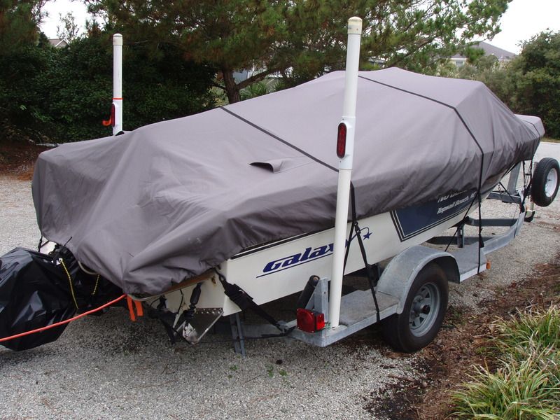

They are very easy to install in the driveway with just a few ordinary tools. If I had to make one suggestion, it would be to buy the tallest posts you can get away with. Having them higher than the gunwales of your boat make them much easier to see in the rear view mirrors, particularly as you back down a ramp. They also are a very handy place to mount lights. I went as far as to buy an add-on backup light/turn signal LED doodad that allowed me to extend my posts even higher. The LED lights are mid shaft, and then I mounted more LED turn signals on the very top. Having your lights high like that keeps them out of the water so corrosion and bulb breakage become just that much less of a problem.
I'd show you a picture but I keep getting upload errors. Then it tells me to please upload at least one photo. It's not like I haven't tried. Here's Plan B:
http://i481.photobucket.com/albums/rr178/jayhanig/Boat Cover 005_zpsn6g2dkfo.jpg
Those look awesome!

Thanks. They are probably the best thing I've done to that trailer.
Would you perhaps be able to provide links to the materials and lights you used, id like to make a pair of those myself.
The guides with the LED end caps are available here. The end cap can be installed on the end of any appropriately sized PVC pipe; not just the one it comes with in this kit.
I can't find the LED pipe light kits here but I bought mine at Ace Hardware, IIRC. They also sell them at that large marine supply chain that starts with W and ends in T, though their customers don't rate them highly due to some reliability issues. The one I bought at Ace has been rock solid for me.
So you buy the guide ons, slide the pipe kit on the end of it instead of the cap light, then add another length of PVC to the top of the pipe kit (whatever length you want), and finally cap it with the LED fixture that came with the guide on kit. None of your connections should ever get wet, and you will have position lights, turn signals, and brake lights.
BTW, I read a negative review of the guide on posts whining about having to drill holes in their trailer to mount them. I certainly didn't. Mine are attached with U-bolts quite solidly. Hope this helps.
