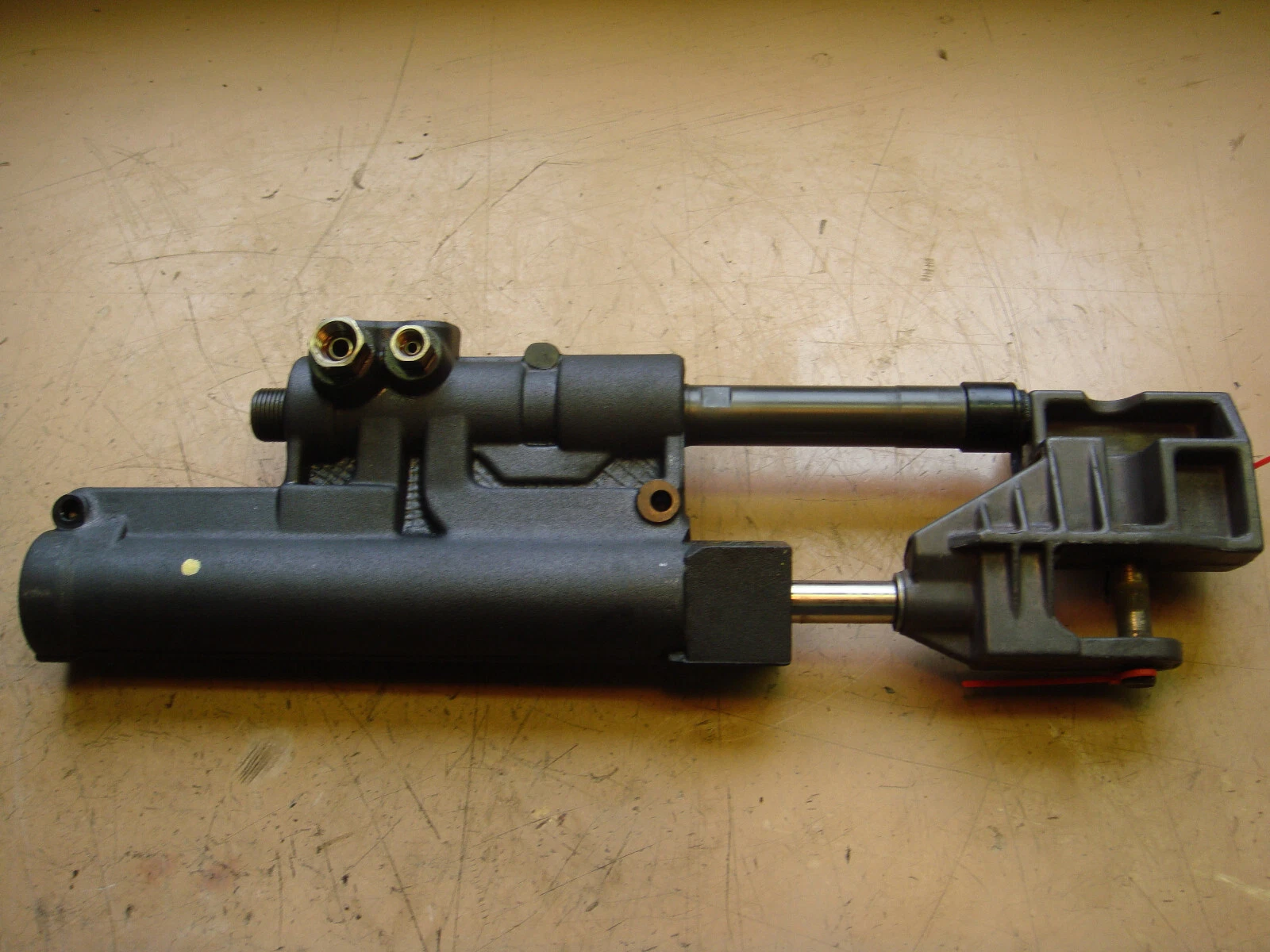

Update:
So after 2 weekend trips, I got the part replaced. It works, but is still tight. I noticed that the fittings from my old one and new one were backwards.
(I have a image, but cant upload here for some reason)
Basically the old one has big fitting left, small right. https://i.ebayimg.com/images/g/4nsAAOSwUp5kCNJz/s-l1600.webp
New one is opposite https://www.myinboardmarine.com/cdn/shop/products/21910902_b_1024x1024.jpg?v=1579535359
Should that matter?
My next step is to investigate the pump.

can't say about the reversed fittings, have you looked at Volvo parts diagrams for your engine model #? might be one way to tell....

Im not 100% sure where to find the diagram. I have SX-M model outdrive system, so went off those.
I dont see any other part that would fit, other than the one I have. On Ebay, most are like the new one, a select few are like my old one. I think its not a true VP part to begin with.
Ayuh,.... Merc, 'n Volvo both use the same actuator,.....
I believe both of those adapters screw into a 1/4" pipe hole, so they may well be swappable,....
There is a Volvo online parts catalog that is part of this site I think. You plug in your engine model # and then look for individual sections.

They are two different sizes even taking out the adaptors.

Best I can see its what I bought is correct. The old one is just.......backwards.
Question is, does it matter? and why are they different.
