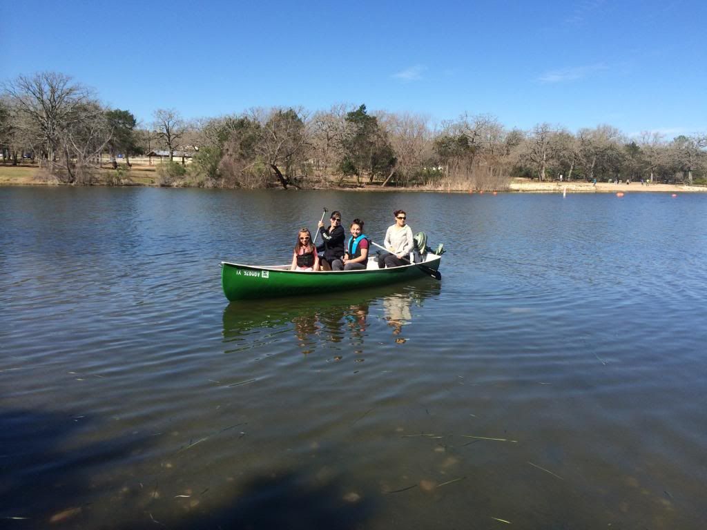

I have been off the forum for some time and wanted to post a final update to this project. I actually did finally finish this first fiberglass boat project and it turned out great. I spent about a week earlier in the spring doing all the final work. I used WOG's painting technique for the outside and rolled on some gelcoat on the inside. It is by no means a showboat, but as you can see in the photos, we have had a great time in the little green boat and have used it to catch some nice fish on lake Bastrop.
My wife and sister in-law with the kids for a joyride:
(my boys) out on a joyride
My oldest with a great bass I had just snagged with a 10" powerworm: Notice the hastily installed front seat :)

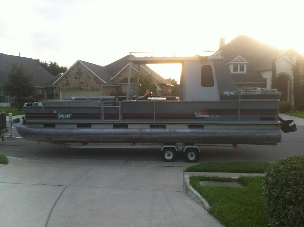

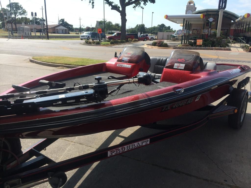

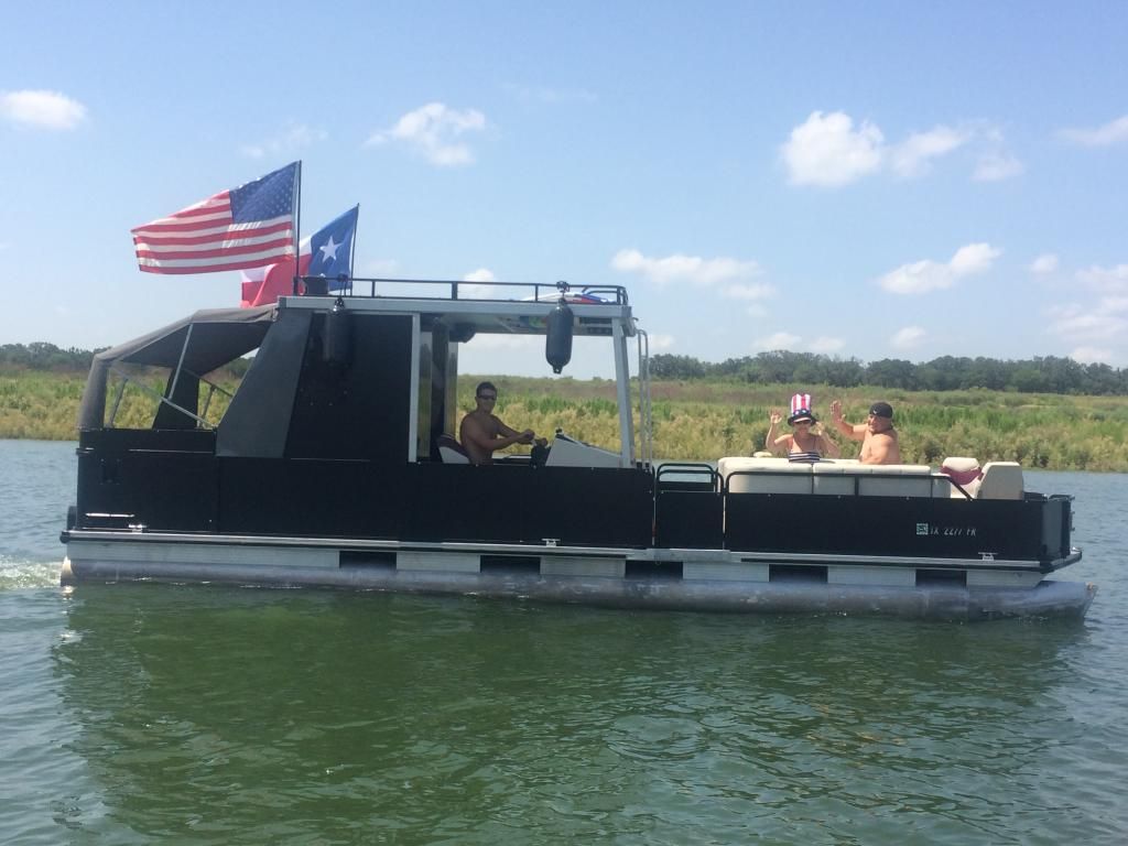

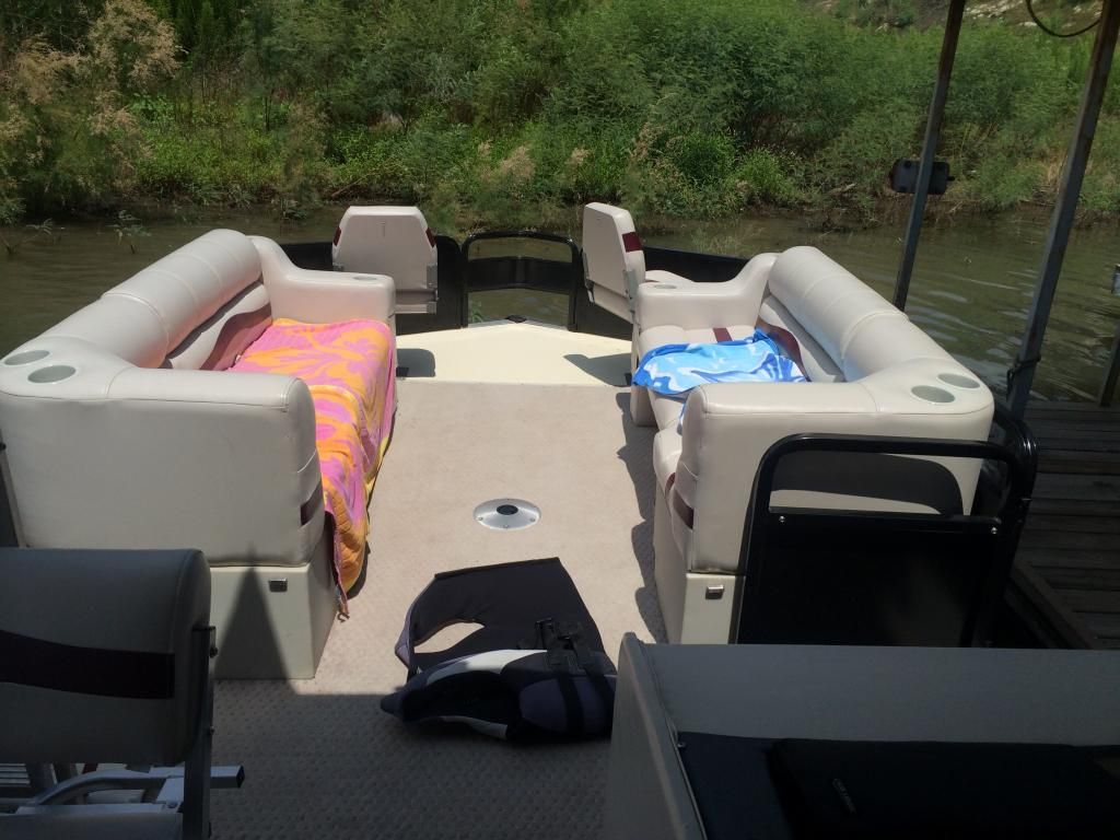

I want to thank WOG and all the other great Iboat's members that helped me so much with my first fiberglass boat experience. It is a great feeling to be able to enjoy something that you put so much time and effort into. The work I did on the little boat inspired me to do another project. It isn't fiberglass, but I did use some of those skills in parts of the project. [rebuild thread on another pontoon stuff forum]
We turned this (1989 30' Tracker Party Hut)
Into This:

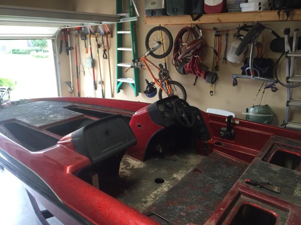

And now I have this in the garage: (18ft Pro Craft Bass boat)
So, it does become something of an obsession for those of you who have been watching from the sidelines. Boats are great and the people from Iboats Forums even better. Thanks guys!

Thanks everyone. Could not have done it all without your help. The bass boat is a simple overhaul. New Carpet, older rehabbed motor, and buffing of the fiberglass. Not too intense. I have been taking pictures and will post the little project once I get some time.

Have you checked the transom on that bass boat to ensure it's in Good Shape??
Something2do
Oct 21, 2012
55
I gave the original motor a pretty hard up and down and did not see any flex in the transom. I also poked around a bit everywhere I could access. Seems very solid. The first owner kept it covered in closed storage and babied it pretty good. The second owner left it in the sun a bit too much and oxidized the gel coat a bit.
