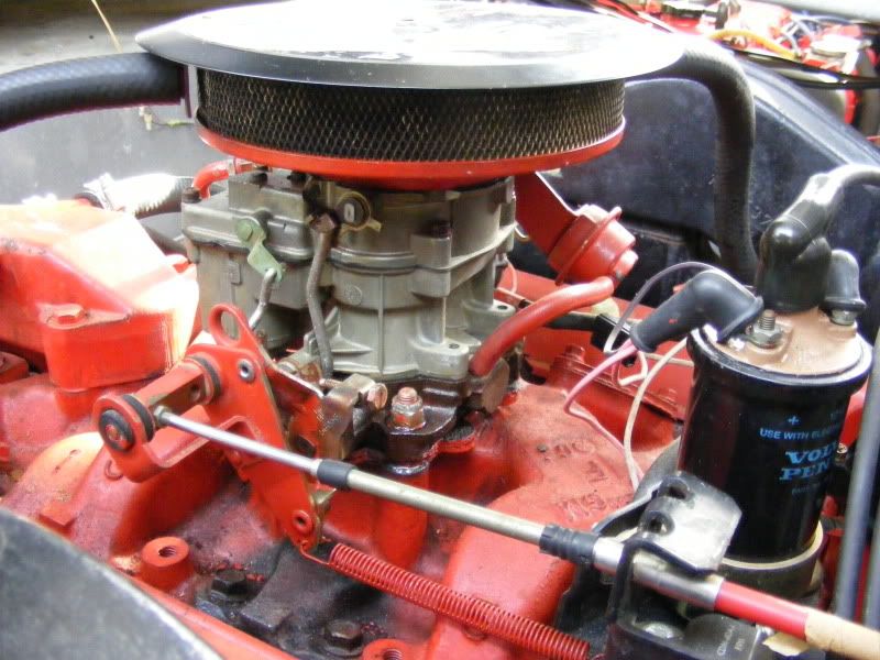

Our coils have two wires coming off of one screw and three off the other screw. On one screw a wire goes to the tach, another to a plug which is plugged into nothing, and another to the distributor. On the other screw one wire goes to the same plug which is plugged into nothing, and then another to the distributor. If you look very closely in the first picture below you will see the two wires going to the plug which IS NOT plugged into anything. Ill assume thats the plug that would be going to the rev limiter which means we do not have one.
NOTE: The intake screens have been cleaned. :)
Note#2: that little diaphragm attached to the side of the carb is what was causing the vacuum leak. The other thing with the wire going into it closes the choke while the vacuum opens it.
