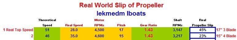

Well I have good news and bad news . . . Bad news first. 17" pitch = 44% slip.
Here's the good news. I am not confident at all in evaluating a somewhat heavy, single screw cruiser as far as slip is concerned. I actually think you need more diameter, but I really have no clue . . . Hopefully hwsi will happen by.

In my opinion this boat is a prime example of how changing to a better 4 blade prop from a 3 blade can increase the top speed dramatically. Usually an easy way to tell if you will gain speed with a 4 blade prop versus a 3 blade is if your prop slip is above 16% to 20%, and it does not matter whether your boat is large or small and whether you have a small outboard or a large Inboard or inboard/outboard, prop slip is the only thing that matters in these circumstances.
My preliminary analysis shows you should gain at least 7 MPH with the change. I would appreciate it if you will fill out the form so I can do a more thorough analysis.
Prop Slip
I also would like you to verify the maximum RPM with a mechanics tach, as 45% prop slip is as high as I have ever seen on a boat. Also look at the bottom of the boat and ascertain if there is any growth or buildup that is causing this problem.
