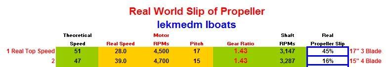

Lek, depending on the HP actually being produced by your motor you should be able to run at least 39 MPH with your setup.
You need to remove the hydrafoil from your motor, as everyone else is suggesting, they are actually designed only for boats that can lift the anti ventilation plate completely out of the water when running at cruising speeds and faster. When they are below the waterline at cruising speeds they just create extra drag, especially when the outdrive is trimmed up for maximum speed, because of the water hitting the hydrafoil at an angle. You already have hydraulic trim tabs to help hold the stern up and trim the boat fore to aft and port to starboard and the hydrafoil is just an extra source of drag on your boat.
When you want to attain maximum speed with your boat after you reach planing speed, start raising your outdrive up until you hear the prop start to ventilate or you stop gaining speed and then trim it in just until it quits ventilating or you get maximum speed again. Then adjust your trim tabs up for the correct planing angle and your port to starboard trim is even and you have attained maximum speed.
A Solas Amita aluminum 4 blade prop in a 14 3/4" x 15" pitch prop should raise your speed to about 39 MPH with much less prop slip than you have now, although it could raise your speed to a little over 40 MPH, if your motor is really producing about 350 HP. This prop can be bought on Iboats for about $ 110. In a Stainless prop I would recommend a Baypro II in a 16" pitch, but that prop will probably cost you over $ 400. And I do not believe it will give you a speed increase of more than 2 or 3 MPH maximum over the Solas Amita aluminum. Either one of these props will decrease your prop slip tremendously and give you a much better hole shot as well as increase acceleration throughout your entire RPM range and reduce your minimum planing speed a few MPH.
After saying all of this, if Dhadley recommends another stainless prop than I did, I would buy that one instead of my recommendation, as he has a lot more experience with the high performance SS props than I do.
