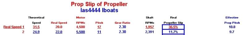

las4444, your prop slip right now is right at 37% and your RPM are 1,000 below what they should be.
Prop Slip
If you will buy a Solas Amita 4 blade aluminum prop in an 11" pitch your RPM will be right at 5,500 and you should gain a couple of miles per hour in speed.
