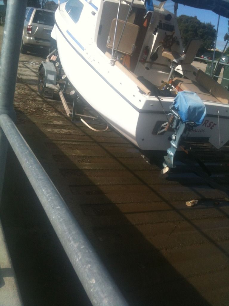

Just make sure you dont pull the pin too early.
Somehow this guy managed to release it about 2m short of the water. Took myself, my mate and his mate standing on the tilt part of the trailer while he handwinched it up the trailer again...only after having to skull drag it up the ramp to flat ground.
