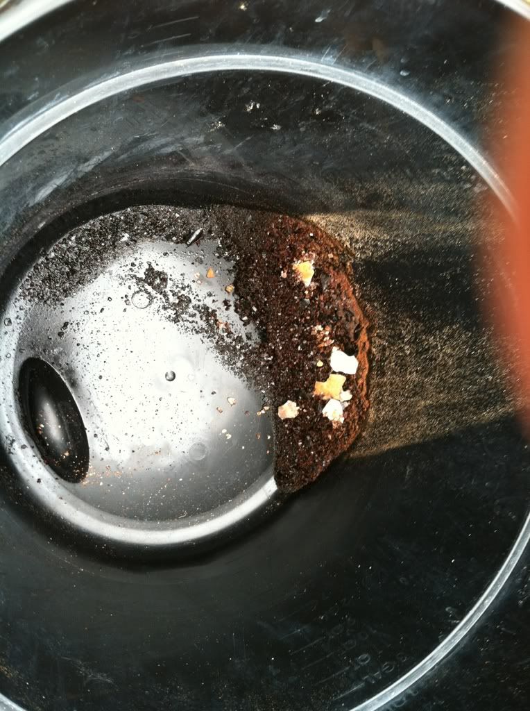

You sure your tank is aluminum? That looks like rust.

Someone used thak tank as a flower pot at some time. I saw the gallon markings in the lower right hand corner. Otherwise I have would never believe it is a gastank.
REPLACE ALL hoses, filters & Have someone who is REALLY good at rebuilding carburators do the cleanout & rebuild of it.
Looks like a sick joke to me. Take that picture with the carb. So the guy knows how bad the jets are clogged.

Yes the tank is aluminum and that is not rust. When it dries it powdery. The tank is actually in
Good shape. The bottom is starting to come clean after soaking with clean fuel.
Uhhhhh....that's not the gas tank...that's a bucket. He never said that was the gas tank.

That's a bucket in the pic. I poured old gas out into the bucket so I could pour old into plastic
Gas tank to dispose.

Maybe the white powder is drugs ? Or Scouring powder from somebody else ?
That tank needs to be cleaned by a tank shop. Or maybe just replaced ? Do to problem of EVER getting the crud ALL loose in the hidden section. Could keep breaking loose forever. DOES HAPPEN in old race boat fuel tanks.

The stuff that looks like rust, is the shellac that has come off the sides of the tank from the newer E-gas cleaning the tank for you. This in turn clogs up everything in the system, and can be a show-stopper out on the water. If you've gotten the majority of it out, replace your filters, and run the boat. The ethanol fuel that you put in the tank will continue to clean the inside of the tank for you. If you have an older boat, and you haven't replaced the fuel lines yet, do it now, before you start using the ethanol fuel.
Oh, and don't forget to clean out the screen in the fuel pickup tube in the tank.
